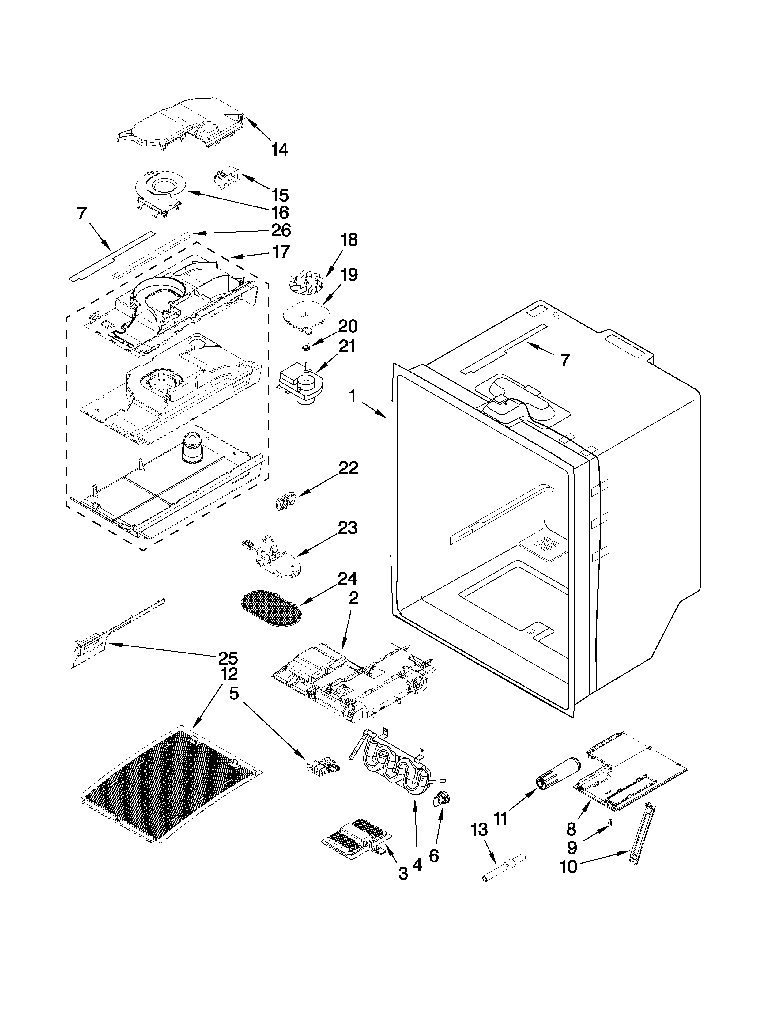

The tech. determined that... the ice maker fan wasn't working
#21? Motor-evap

Yup Jeff, #21. And for today's long update: Tech. called to let me know that he couldn't order just the new fan and would have to order an entire new ice maker for $500 including installation. I thanked him for his time (already paid for the service call yesterday) and jumped online and found what appeared to be the correct part number. I can't tell if the one you linked to, Jeff, is the same as what I found, but the motor itself is the same as the evaporator fan motor in the freezer and most of the sites want to sell you that one, but the wiring harness is different and there is a bi-metal switch attached which isn't needed. I couldn't be sure of this, so I finally just gave up and pulled the refrigerator apart to get the fan out so I could look up the part number directly. It's a Panasonic motor that I found on Amazon for much less than the appliance part sites. Part ordered and will be in next week (I hope). In the meantime, I've got the ice maker assembly out and the fridge has cooled way down. In fact, it's cooled down a little too much and no matter what I set the temp to, the evaporator fan won't stop. I've stopped the compressor for a while by turning the freezer temp up and, as long as it's not running, the temp in the fridge section is somewhat stable, but it appears that part #15 is the only air damper between the sections and it controls the lower evaporator fan too. Guess it's a catch 22... Ice maker in and not enough cold air gets to the fridge. Ice maker out and too much cold air gets to the fridge. These modern gadgets are complicated! I'll have to try and find a balance setting where the freezer runs just enough to keep the freezer frozen and the fridge... not frozen. It's going to be an interesting weekend.
