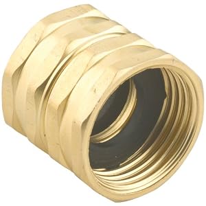

Haven't used my cheapy small "no-name" electric power washer for a number of years and I can't remember how to attach the garden hose. It has a male fitting. The power washer also has a male fitting. Help. Any suggestions. I know I'm missing something obvious(in addition to the manual, and getting old (me,that is)).

It sounds like you need a double-female connector, or one of the "quicky" adapters HERE.

Thanks everyone for your replies. I'm absolutely sure the fitting I have to work with is a male fitting. I solved my immediate problem by placing two female hose fittngs in the opposit ends of a short piece of old hose. My Lowe's didn't have a double female hose adapter. I now vaguely seem to recall that my cheapy washer came with just such a length of hose. Why, instead of a female fitting? Who knows. As I said. My washer is a no-name. cheapy bargain from a local big box where my sister-in-law worked. What can I say. Ten years ago the price seemed right. And it still works.

I believe washing machine hoses are female/female hoses and may work.

True, but a $5.00 female-female adapter is cheaper and available at any hardware store.
