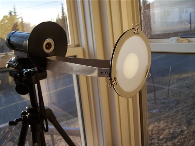

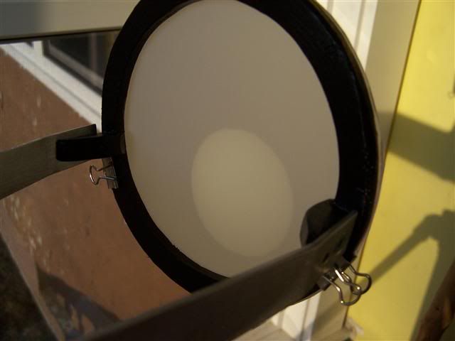

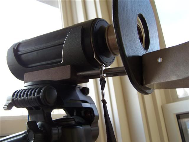

Here's a solar projector I built to add to a small Russian LOMO (20x, 40mm) Mak-gregorian spotting telescope I have. This sort of arrangement will work on any telescope smaller than about 3" aperature, so long as the internals of the scope are not plastic (which presents a melting hazard!).
This spotting scope had no tripod mount, so I made one with abs pipe and a maple block. The projector attachment slipps into 2 holes in the maple mounting block, with 3/16" steel rods.
At the eyepiece of the scope is a plywood disk, just to cast a shadow over the viewing screen.
Then an aluminum strut is mounted to this, and carries a plywood ring with maple screw lugs at the back end. A translucent screen (in this case, a plastic drafting medium, but waxed paper is almost as good, and white paper works too) is clipped to the ring. The translucent screen I used allows the image to be viewed from both sides of the screen.
With this, you can easily observe any significant sunspots, Mercury transiting the sun (occasionally) or Venus doing the same (one opportunity this summer, best for west coasters, then no chance in our lifetimes), or solar eclipses. You can see a hint of the spherical shape of the sun in the way the image darkens towards the edges... Called Limb Darkening, it makes the sun appear distinctly not flat.
There were only 2 tiny sunspots visible yesterday, and they're too subtle to be seen in the photos, sadly.
