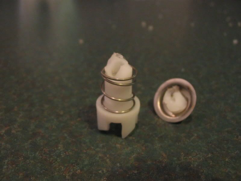

Since it's wiggling (floppy?) and not just spinning, your coupler teeth may be broken or not engaged. (I'm guessing)
The spring should be uncompressed, pushing the white shaft towards the motor.
At the top end of the white shaft in this picture, you can see that there are 4 white teeth. These need to interlock with the black driveshaft's teeth where that comes out of the motor.
The ends of the mating fingers are angle-cut, so they will self-align and engage with each other as long as they are on the same axis. The black shaft has a central guide pin in the center that mates with a hole in the end of white part.
My chopper shaft was broken like this one: You can see the teeth that engage with the black driveshaft. (The chopper blade, washer, screen, washer that goes between the metal "cap" and the spring are missing from this pic.)

Hi everyone!! I am new to this forum and glad I found it.
I was just researching a similar problem and came across this thread and I must say it is the most informative I have read!! Not to mention the most helpful.
I found the problem of a clogged chopper a couple years ago on my Kenmore Ultra Wash (sorry I don't have the model# on me but it is identical to the pictures I am seeing). I also had to clean it out every once in a while when I noticed the top rack not getting cleaned.
My problem now is that it gets clogged quite often and the there seems to be some type of fiber plugging the holes which prevents food bits from being pushed through and then it clogs. Has anyone else had this issue? Might it be something wearing out? Rubbing and shredding something? Sorry I did not take a picture but it looks kind of like dryer lint. I can't find anything in the dishwasher, we don't put anything other than dishes in it, no labels or glue from containers, and this has been happening for a while which makes me think something is wearing because something that was dropped inside should have made it's way through by now and not keep plugging over and over.
Any ideas? Thanks in advance for the help!!

Food lint looks similier/like clothing lint.
Also check water temp ( closer to 140F is better ) because if the soap isn't desolved properly any food bits will not be held in suspension and drained away.
Chopper may be damaged and not doing it's full job.
jeff.

Thanks, I'll check on the water temp. I wondered the same because we were using the "puck" type soap and maybe it had something to do with not heating up enough and dissolving. Mid wash I opened the door and there seems to be lots of heat but I will check with a thermometer to be sure. We have since switched back to a liquid soap.
When the screen has been freshly cleaned the dishes are sparkling. Sometimes it only takes about a week to clog up! The fibers seem to be really caught up in the screen holes and the chopper appears fine. Should the blades on the chopper be sharp? It seems to me that it just crams and mashes the food through.
Thanks again for all your help!!
P.S. I have never actually heard of food lint. If that is what I got it sure is excessive. I'll take some pics next clogging.
Not overly...more smushes the food down.

Hello! This is a great post. I am making progress on fixing my 66516882000 because of this post. I can't get the inlet protector off to see the chopper assembly. I have already removed the inlet protector screw, the foreign object protector, and the foreign object protector screw. Any ideas? I've been trying to pry it out but it's not budging.

Okay, used a pliers to yank out the inlet protector. The chopper assembly fell apart immediately into the sump area. It looks from parts pages and videos that this assembly is supposed to stay together, so I ordered a new one. It's not clear to me from the pieces what happened to it. I'll reply again after I get the new assembly.
